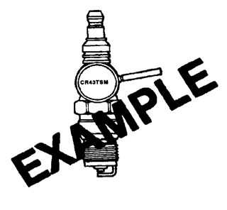

Resistor type spark
plugs with tapered seats are used. No gasket is needed on these plugs. These
spark plugs are a High Efficiency (HE) spark plug that has a fine wire
electrode,
