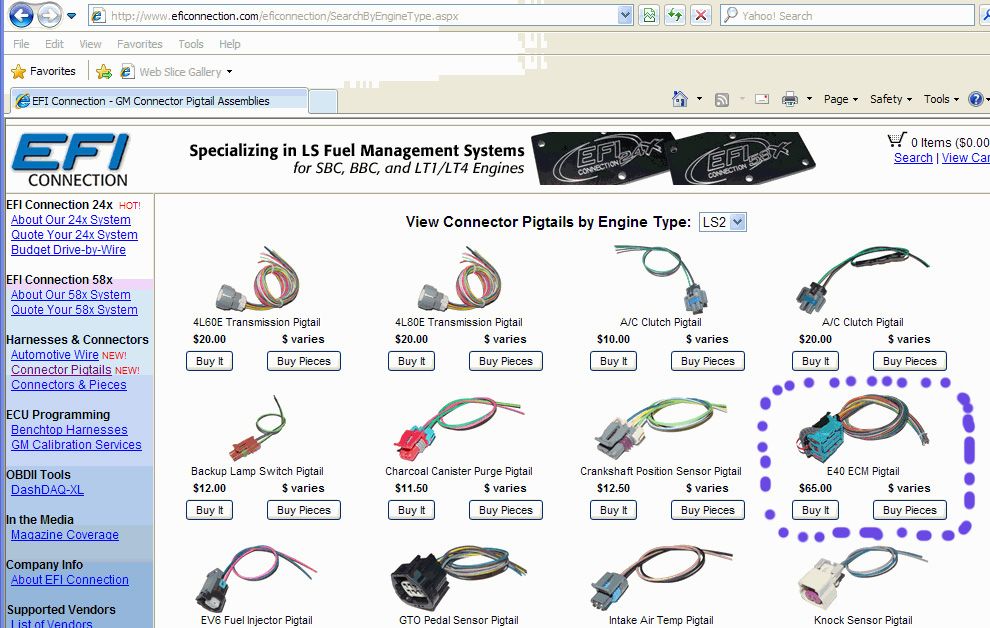

    Hi there,
    J1 is also sometimes refered to as C1
    http://www.eficonnection.com/
    Click on "Connector Pigtails"
    Click on "Search by Engine Type"
    View Connector Pigtails by Engine Type: Select LS2
    E40 C1 56way Blue Connector
    2005 GTO E40 C1 Pinouts
    http://www.ls2.com/forums/showpost.p...0&postcount=22
    2005/2006 GTO Wiring Info
    http://www.ls2.com/forums/showthread.php?t=833000

    You need the C1 and all its wires connected into your harness, plus you'll need the Vehicle Anti Theft turned off and a tune added into ECU.
    You'll probably want an OBD2 port added to the harness.
    There will be parts of your GTO harness which just wont have anywhere to plug into your Jeep.
    Seriously I'd consider boxing up the ECU & harness and sending it to a professional to get everything done for you and to suit your Jeep.
    (One major reason here is your location.....parts and support for this equipment will be scarce there where you are.)
    Look here
    http://www.speartech.com/
    Click on LS-24x
    Scroll right to the bottom.....Reworked factory harnesses.

    i got my c1 plug from efi connection, as well as my gas pedal plug. shipped quick.
    the GTO harness isn't too difficult to mod yourself. the c1/j1 is almost all in car/cab stuff and the main wiring harness that goes on the motor really only needs to get power connected for the injectors and coils at a plug near the TB.
